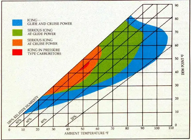

The coolant line are to prevent icing of the throttle body and sticking of the throttle butterfly during cold, damp weather. Any time there is a pressure drop where there is a gas flowing (air, Freon, refrigerant ,etc.) there is a temperature drop that goes along with it.
If you ever piloted, or worked on the engines of a piston engine aircraft, you would have familiarized yourself with the carburetor heat control. It is there to prevent icing of the throttle butterfly on an engine at low power or decelerating.

Ford is cheap and if they could have saved some $$ by not including it in the package they would have done it. The later models used a different upper intake without the coolant passages.
Throttle Ice. This is the most common, earliest to show and most serious carburetor icing. It is formed at or near a partly closed throttle valve (sometimes called the “butterfly valve”). The water vapor in the induction air condenses and freezes due to the venturi effect cooling the air as it passes the throttle valve. Since the temperature drop is usually around 3°C, the optimum temperature for forming throttle ice is between 0°C to +3°C although a combination of fuel and throttle ice could occur at higher ambient temperatures.
See Piston Engine Induction Icing - SKYbrary Aviation Safety for more information.
High humidity seems to be the key factor for icing. Very cold air does not hold much humidity.
