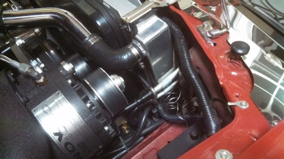

Noobz347 said:
Not sure if serious.
Now I wouldn't tell a fib.
Look close. See the little brass cap? That ain't no charcoal canister.
Admin Dude
Jan 4, 1985
43,356
21,558
Box behind Walmart
Apr 25, 2015
#48
  • Apr 25, 2015
  • #48
Why would you intentionally vent a fuel tank line into a frame rail though?
Onefine88
Previously 89SSC18
Aug 3, 2006
1,422
796
154
Apr 25, 2015
#49
  • Apr 25, 2015
  • #49
The end of the line was laying where the canister once hung. There is a square little opening in the frame there. I stuck it in.
Why not.LOL
Why not.LOL
Well emmmm.... because you're venting fuel vapor into the frame rail from the engine bay?
Hell I dunno, mount a spark plug in there with a DO NOT PRESS button on the dash.

Gearbanger 101 said:
Kinda wondering why you deleted it at all? The canister is tucked down pretty low and out of the way. Not really an eye sore?
If your question is for me. I deleted it all because my car is nearly 28 years old and I no longer wanted it on my engine. LIke I mentioned before I deleted the canister because I needed to use that location to mount my Methanol/water injection reservoir. It needs to be located below the blower.
I originally had plans to relocate the canister in another location down there somewhere behind the scenes but haven't got around to it. Might put it inside the fender liner.
I da know
@Newbz347 I see your point on the vent line. Didn't think of that and I will remove it from the frame rail until I come up with a good plan on possibly reinstalling the canister somewhere. (just in case)

Yeah man, put a small filter or something on it and at least vent it outside of tbe engine bay until you can find a more permanent solution.

Definitely vent it somewhere where the fumes cannot accumulate.

Why not just hook it back up to the intake ,like ford had it

You don't want to vent uncontrolled into the intake.
Back in the 70s all cars just vented the tank. The key is venting it in such a way to prevent explosive vapor buikdup

ok so if I should not put the hose back on the intake,, where should it go?

I think I will just put the hose in the inerfender, with the air filter, [ power pipe]

Just vent it somewhere that would get decent air movement.
