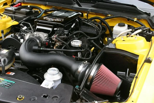

I can only comment on the AirAid, as that's what I have. With the stock air box and a K&N drop-in filter, to the AirAid CAI, I gained 6rwhp between dyno runs and hit the mystical 194rwhp wall :( - I like the look and was easy to install myself.:nice:

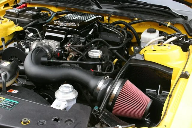

Here is the stock air box vs the C&L in back to back dyno testing on my car. While it may not be as big as the claims there is a definite gain! There is no denying that things have improved!
Now that I've uncorked my exhaust it would be very interesting to repeat the test and see how the stock air box compares to the C&L... Unfortunately I don't have the time or money to try it... :shrug: But I'm betting there my be a bigger difference...
