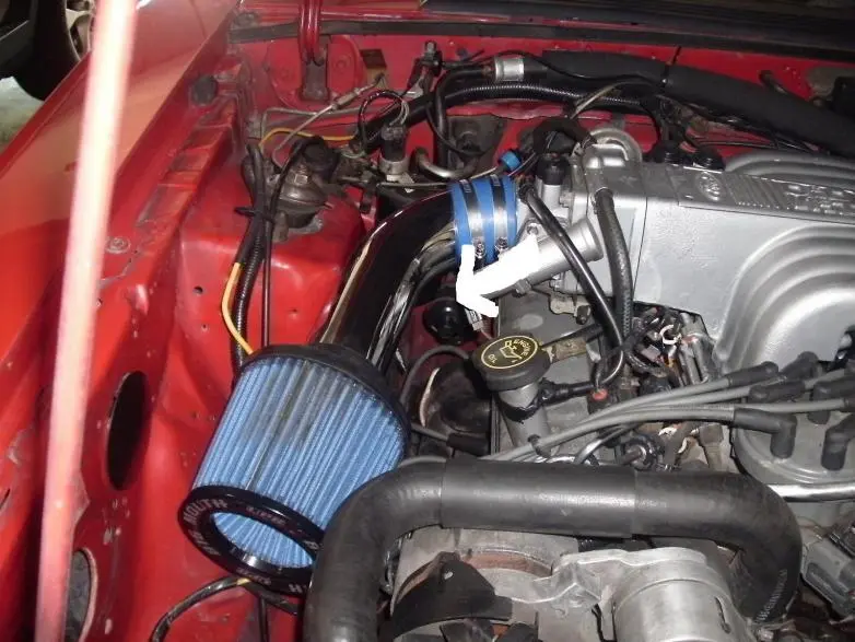

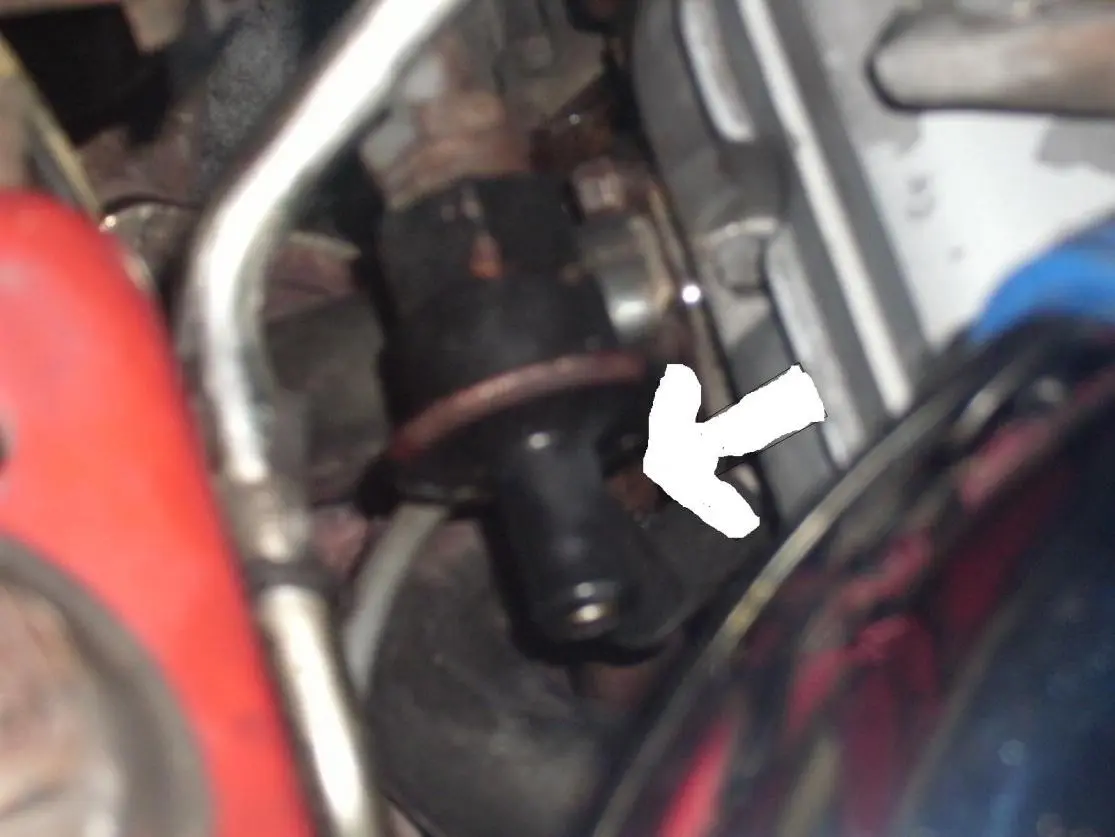

I was just looking around my engine then saw this. i have no idea what it is. any help??

That part goes to the thermatic air system. the hose from the smog pump would connect to it. someone removed the smog pump and left the rest of the system, like the others stated no the best way to do it. If you are still running cats you run the risk of plugging them if you don't feed them with fresh air.
