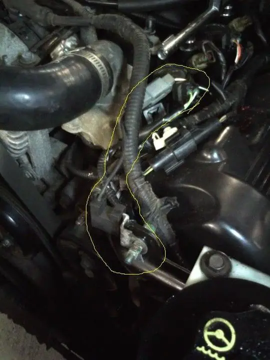

I am not a 4.6 guru at all, but I replaced the chains on wife's 4.6 I am having error codes regarding the coils, and noticed I am missing this part on the right bank. Can you tell me what it does?
(My mustang has plug wires :) )

Radio interference capacitor.
It's purpose is to provide a path to ground for the high frequency electrical noise that sometimes occurs in the ignition thus reducing possible Radio interference.
