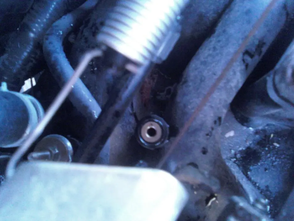

What is this?(pic)

I was searching for a possible vac. leak and found this....any ideas what this could be? Do your motors sound really "vacumy" to yall?
Sorry that wasnt specific, Im refering to the little brass screw under the spring...

I believe those are brass threaded inserts!

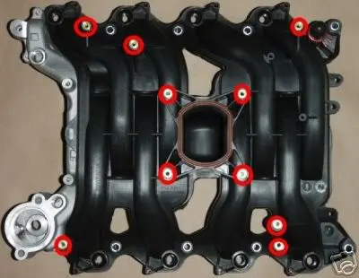

That appears to be the brass threaded insert that is molded into the plastic intake which is used to bolt down things like your fuel rail, throttle body, and other brackets. I have identified those inserts in the picture I posted below with red circles on that PI intake. Your inserts may be positioned differently. Hope this helps, Tommy.
Excellent post Tommy. You have to be careful when screwing bolts into those brass fittings. They are only pressed into the composite manifold, so overtightening will cause the brass fitting to break free...and could also damage the manifold itself. Even if it doesn't damage the manifold, you won't be able to tighten the bolt. I have experience in this situation...I used 5 min epoxy to glue the brass piece into the hole, then gently tighten the bolt.
Yours looks like the manifold is cracked near that brass fitting..? Is that what we are seeing? That would certainly cause a serious vacuum leak!!!
The brass fitting DOES NOT need a bolt in it to seal. With or without a bolt, you should not have any vacuum leaks.
I see what you are talking about in the pic...I did NOT notice that when I took the shot...Hopefully its just a weird glare?? The car runs damn good to have a cracked manifold...let me run outside and check that.

thank you for the suggestions, as there are no doubt a mess load of vaccum lines under there... good news, it is NOT a crack in the manifold, just a weird shot i guess...
