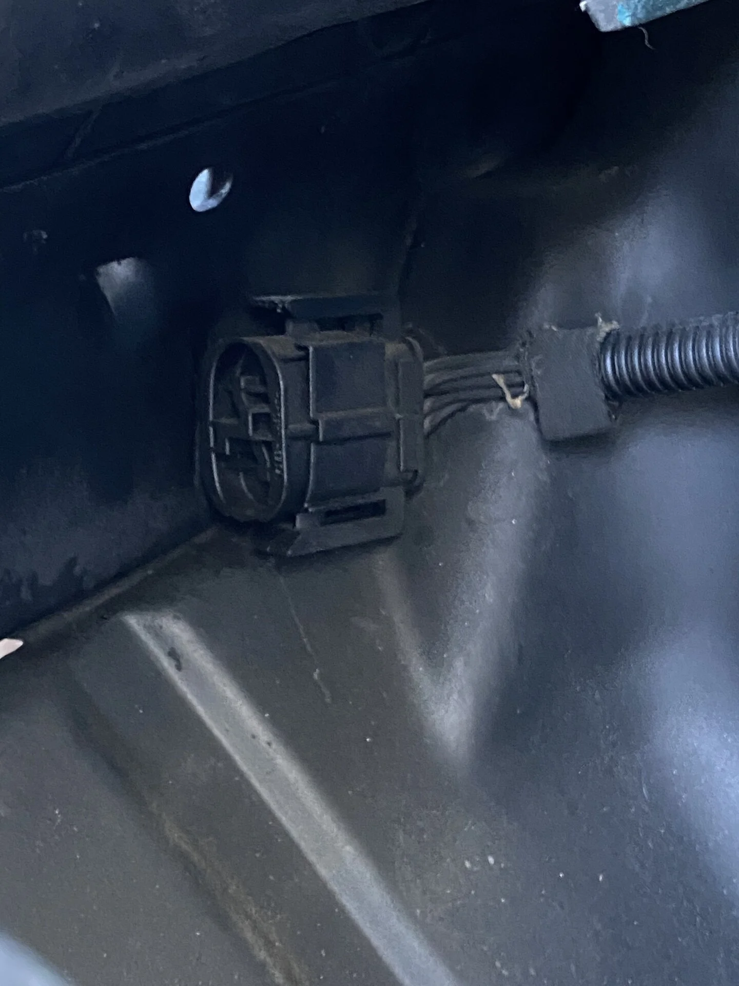

B Blueinfan Active Member Mar 18, 2021 259 60 38 Temecula Dec 12, 2021 #1 Dec 12, 2021 #1 Does any body know what this plug is for? Plug is right by the horns on a 1991 Ford Mustang Convertible LX Attachments 6DE1EA8F-AC71-4075-A6FF-237559128E33.webp 168.9 KB · Views: 158
Bullitt347 I have been doing it wrong this whole time 15 Year Member Mar 23, 2007 3,998 2,984 194 Middle of Maine Dec 12, 2021 #2 Dec 12, 2021 #2 For fog lights. If the car was a GT it would have fog lights. Reactions: Blueinfan
Mustang5L5 That is…until I whipped out my Bissell Mod Dude Feb 18, 2001 43,299 18,005 224 Massachusetts Dec 12, 2021 #3 Dec 12, 2021 #3 I actually think that’s the Daytime Running Lights plug found on the 1990+ cars. A shorting plug is installed on the US cars, which is what that appears to have. Canadian cars would have a module installed there Reactions: Blueinfan
KRUISR 10 Year Member Apr 16, 2015 1,858 989 143 Dec 13, 2021 #4 Dec 13, 2021 #4 I agree with Mustang5L5, it would have 7 wires coming out of it. Yes, daytime running lights became standard on all Canadian sold cars in early 90's, all makes, all models. Reactions: Blueinfan
B Blueinfan Active Member Mar 18, 2021 259 60 38 Temecula Dec 14, 2021 #5 Dec 14, 2021 #5 Thank you! The car is a 1991 Ford Mustang LX Convertible 5.0. Won't be needing that so will leave it alone. thanks!
