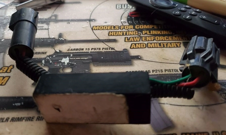

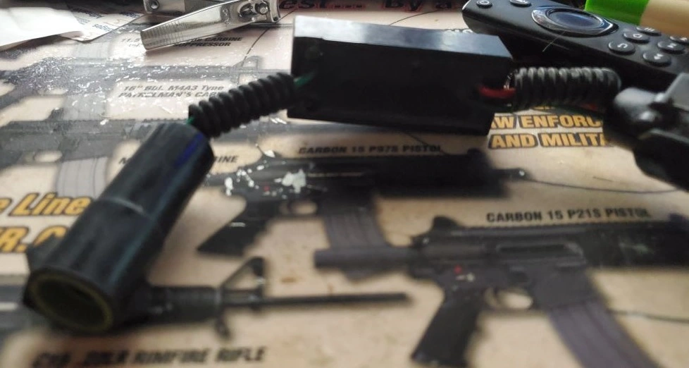

R rep1969 Member Oct 20, 2005 4 1 13 Aug 10, 2020 #1 Aug 10, 2020 #1 What is this thing? It attaches behind the TPS sensor. It is hard to see in the pics but it ha a red and green light on the back. Thanks.
7991LXnSHO wanna catch the space herp 10 Year Member Sep 1, 2010 7,387 2,745 194 Kearney, NE Aug 10, 2020 #2 Aug 10, 2020 #2 There were throttle response enhancer Or TPS signal smoothing gadgets on the market. If there is no part number on it and no maker’s mark, that’s my wild guess.
a91what SendMeUrDataLog 10 Year Member Apr 6, 2011 10,739 6,720 214 Hillsborough county Aug 10, 2020 #3 Aug 10, 2020 #3 sounds like snake oil Reactions: revhead347
R rep1969 Member Oct 20, 2005 4 1 13 Aug 10, 2020 #4 Aug 10, 2020 #4 The label is wiped. I can find no other markings on it.
Ryuk I love your drawers 5 Year Member Apr 22, 2017 1,675 1,592 133 Aug 10, 2020 #5 Aug 10, 2020 #5 View: https://youtu.be/DU_Gd623HJo?t=20
Willybill32 But at least it's tight! 5 Year Member Jul 16, 2019 625 347 83 Lexington, KY Aug 10, 2020 #6 Aug 10, 2020 #6 What year? I assume it's a 5.0?
Mustang5L5 That is…until I whipped out my Bissell Mod Dude Feb 18, 2001 43,145 17,841 224 Massachusetts Aug 10, 2020 #7 Aug 10, 2020 #7 https://rover.ebay.com/rover/1/711-...0001&campid=5335821607&icep_item=184363120738 Casper's TPS Enhancer They still make them for other vehicles, but have been discontinued for the 5.0. It's snake oil
R rep1969 Member Oct 20, 2005 4 1 13 Aug 10, 2020 #8 Aug 10, 2020 #8 Thanks for the replies. It is a 1989 LX 5.0. Reactions: Willybill32
Willybill32 But at least it's tight! 5 Year Member Jul 16, 2019 625 347 83 Lexington, KY Aug 10, 2020 #9 Aug 10, 2020 #9 Mustang5L5 said: https://rover.ebay.com/rover/1/711-...0001&campid=5335821607&icep_item=184363120738 Casper's TPS Enhancer They still make them for other vehicles, but have been discontinued for the 5.0. It's snake oil Click to expand... What was it supposed to do? How do you “enhance” the TPS?
Mustang5L5 That is…until I whipped out my Bissell Mod Dude Feb 18, 2001 43,145 17,841 224 Massachusetts Aug 10, 2020 #10 Aug 10, 2020 #10 At 70% throttle it bumps the tps voltage to max to fool the ECU Into thinking it’s at WOT. Changes fuel and timing slightly. It’s just tomfoolery. Last edited: Aug 10, 2020 Reactions: Neuron and Willybill32
