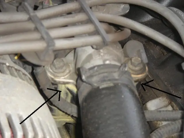

What is this?? I have a 96 GT and my radiator light has been coming on. Under the hood I see THIS leaking radiator fluid from the seams. Any idea why it would out of the blue start leaking. It leaks alot more when I run my Air Conditioner. Sory for the noob question. Any advise will help. Thanks.

I checked and the therm housing is tightened down. I dont understand why sometimes it leaks alot and other times it is bone dry. Any thoughts? AND is there a sealer I can use or does it have to be a gasket just made for the housing?
Another possibility is that the leak is comming from the hose Itself (near the clamp) and running down on top of the t-stat housing flange.
If it's the gasket, just buy a new one. They're cheap.
wipe your finger under the radiator hose along the clamp and see if there is any moisture or coolant on your finger. Those spring load clamps are known for loosing strength over the years. If not remore the housing and replace the t-stat gasket.

There is a shop near by... I will have it checked out. I was hoping that if it was a crack then I would be able to see it. I just checked it again and the only part that is remotly damp is the seal around the themo housing gasket
Add some coolant if you need to and let it run. Watch the area that is leaking with the car running and try to see where it's leaking.

OK, last question... Any idea why it doesnt leak when I drive (its bone dry), but when I let it sit over night it leaks from the therm housing area. I imagine it has something to do with the temp. Thanks all for your help.
This is why I believe the gasket/hose theory. It's sounds like it's not leaking under pressure or heat. Perhaps when the metal t-stat housing cools down, it contracts just enough to leak.
