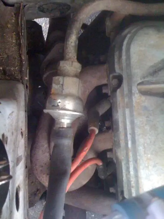

bigvino Member Mar 22, 2010 259 1 19 Corpus Christi, TEXAS Mar 17, 2011 #1 Mar 17, 2011 #1 what is this and where does the hose connect to?? right now it looks like its a garden hose and its connected to nothing.. i think it has something to do with the vacuum
bigvino Member Mar 22, 2010 259 1 19 Corpus Christi, TEXAS Mar 17, 2011 #2 Mar 17, 2011 #2 this is on the passenger side right next to the valve cover.
F FobraR Member Jul 11, 2003 120 0 17 Southern California Mar 17, 2011 #3 Mar 17, 2011 #3 It connects to the TAD valve coming from the smog air pump. Do a search on smog/air pump stuff and you'll see how everything hooks up.
bigvino Member Mar 22, 2010 259 1 19 Corpus Christi, TEXAS Mar 17, 2011 #4 Mar 17, 2011 #4 thanks!! it looks like there isnt a smog pump...soo i can pretty much plug it up right?
SMOKEDYA 20+ Year Stangneter Jul 13, 2003 3,637 8 79 Tucson AZ Mar 17, 2011 #5 Mar 17, 2011 #5 yes you can just plug it.But if you have emissions there it might not pass?peace john
bigvino Member Mar 22, 2010 259 1 19 Corpus Christi, TEXAS Mar 17, 2011 #6 Mar 17, 2011 #6 Ok.. any ideas in how to plug it up?
