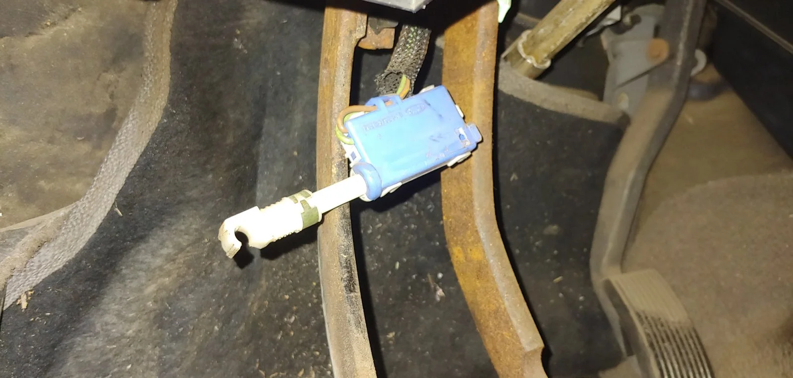

luvformypit Member Oct 15, 2017 16 2 13 Jul 17, 2019 #1 Jul 17, 2019 #1 Been hanging there since I bought the car it actuates in and out Attachments 20190717_201306.webp 107.5 KB · Views: 127 Last edited: Jul 17, 2019
wmburns SN Certified Technician Aug 14, 2009 5,892 514 204 Houston Texas Jul 18, 2019 #2 Jul 18, 2019 #2 How about an educated guess? It's a pedal position switch. Either clutch or brake. Do the brake lights work? Do you have to hold the clutch pedal down to crank? Does the cruse control cancel if the brake pedal is touched? Don't have a clue what model year of your car.

luvformypit Member Oct 15, 2017 16 2 13 Jul 18, 2019 #3 Jul 18, 2019 #3 wmburns said: How about an educated guess? It's a pedal position switch. Either clutch or brake. Do the brake lights work? Do you have to hold the clutch pedal down to crank? Does the cruse control cancel if the brake pedal is touched? Don't have a clue what model year of your car. Click to expand... 1999 mustang gt I have brake lights yes I press the clutch in to start no the cruise doesn't work.

nickyb I gotta say i never painted my nuts, Never Ever 15 Year Member Apr 3, 2009 2,988 1,632 153 nevada Jul 18, 2019 #4 Jul 18, 2019 #4 Looks like clutch pedal switch,that would be why your Cruz no workie
