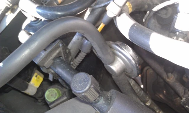

I have a fuel pressure gauge, but I don't see a stock fitting on the fuel rail to hook it to. How do you go about checking the pressure on this system, splice into the fuel line and install a gauge? Is the attached picture showing the regulator, if so, do you install the gauge before or after the regulator?

Yeah don't splice anything, if there isn't a schrader valve on the fuel rail you can get an adapter to go inline before tw fuel rail. But let's not get ahead of ourselves, if you are getting a p0316 now id suspect your having an ignition related intermittent misfire. Check the coil. Sometimes they will get hairline cracks on tw bottom of them. I see it all the time.

A couple of posts back I explained the #3 misfire code I had before replacing plugs and wires. Since then, no #3 misfire. At that time I suspected the coil, but didn't see anything wrong with it visually. Autozone claims that they can't test the coil pack, I didn't want to just swap it out on a hunch. Is there a way that I can test it out. Can the coil have an intermittent problem and not send a trouble code to the computer?
Yeah with an intermittent misfire it might not set a code. No real way for a do it yourselfer to test the coil but I would still say that it is your suspect. They used that same coil on Taurus/ sable, rangers and f150s and they're easy to find in the junkyards.
