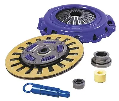

I have always liked the Zoom Kevlar for that type of clutch.
