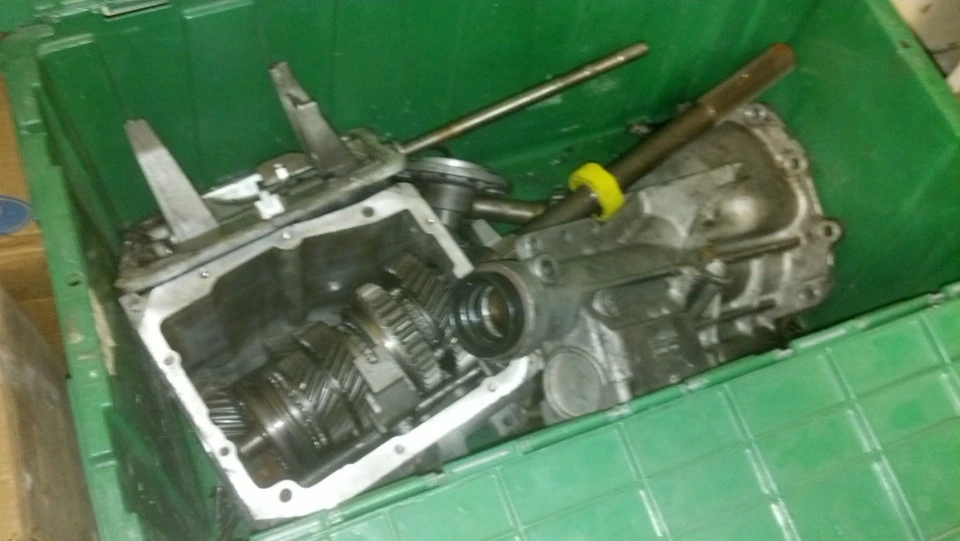

srtthis said:
I'm a firm believer the more you beat them the longer they last
Mmmmm yeah. Can't say I agree with that, LOL. I got two more of these If you need pics of them too..
