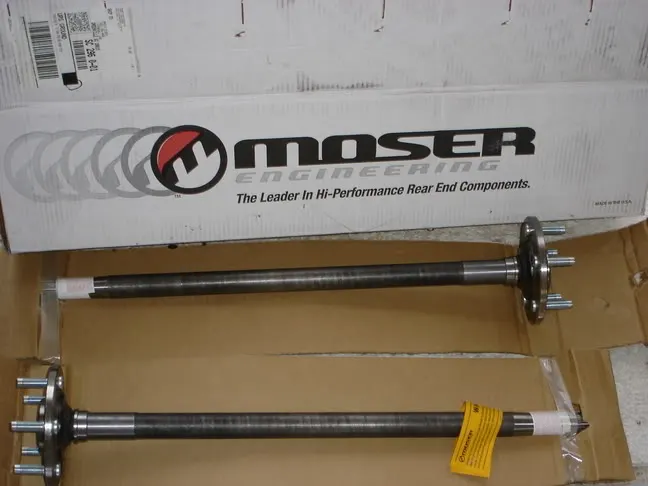

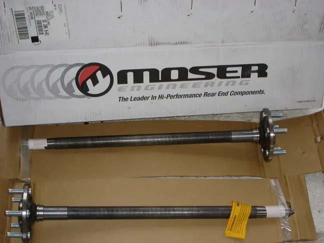

Anyway, besides that, i was once in your boat. I rebuilt my diff and packed it with extra clutches while doing my 4:10's and ordered some 28 spline Mosers in the process. These brand new, with studs, ran me $240 + shipping from Redlineracing in SC. The machine work of them is just amazing. I sat with one on my couch for 20 min admiring it before i put them on.
:drool: those look b-e-a-u-tiful. yeah, i'm pretty sure they are all 40 times stronger than stock, but i guess the price tag is also a decider. i've heard that one is made different than the others? maybe superior. and also, what else would i need for the install. ex: bearings, fluid, gaskets... thanks, i just want to make 1 trip to the store.
