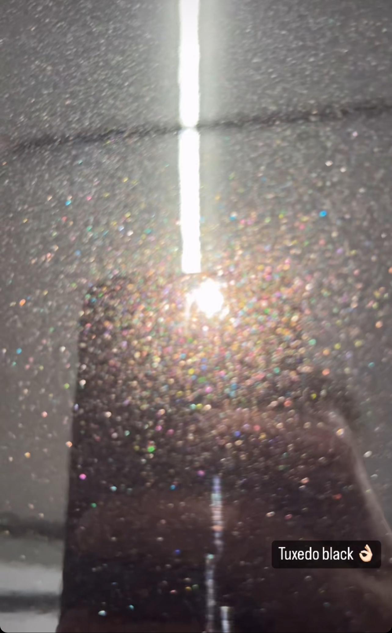

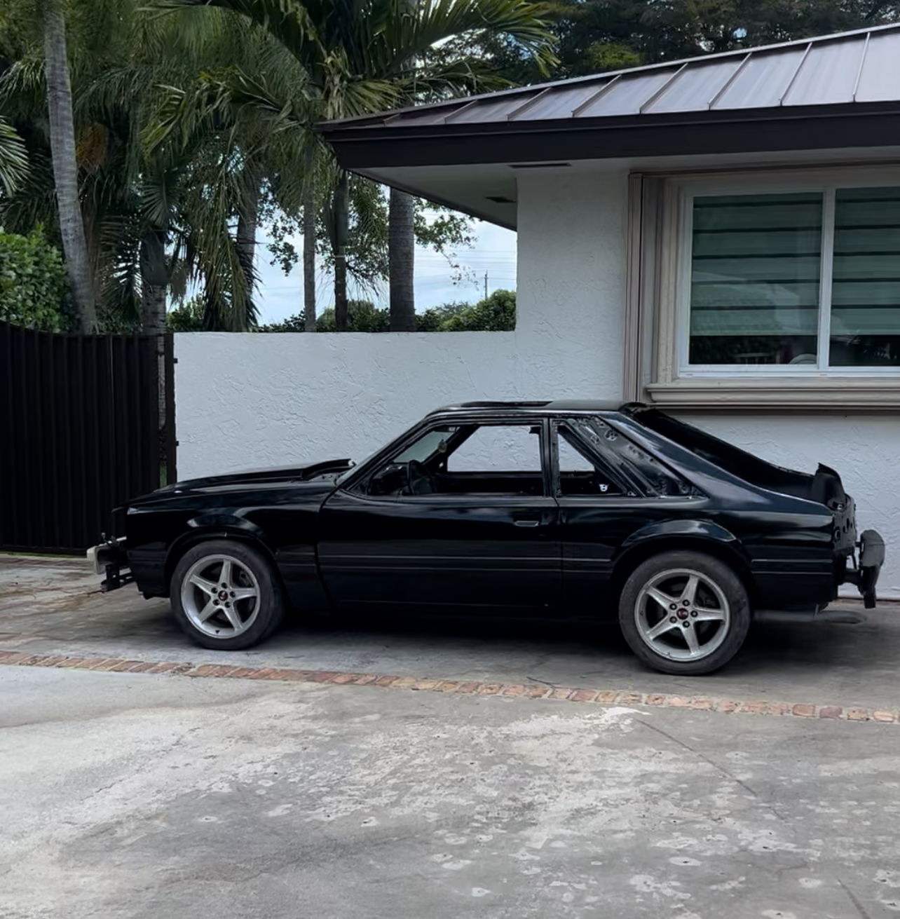

Yep haha. Finally got the car back after waiting almost 8 months. Got it painted ford tuxedo black
