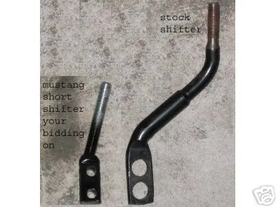

Thanks for the responses but Ive driven the pro-5.0 too and thats not it. Im thinking that the cars I saw was people cutting thier handles down the threads. The shifter was so low that the boot was all wrinkled up (looks almost like a ****er in a Supra or even the new 05 GT). Im not looking to do it, was just trying to find out if it was custom.
I agree w/u 5spd GT, I wish I would have went w/the pro-5.0 rather than Steeda.
haha Ok, I did some searching and I think I may have found it

87GT 306 - Lol...that is a SHORT shifter :) ...but if your money handling can spare it...I would buy a complete aftermarket shifter and not just the handle...because of the built in stops to prevent damage to the transmission and plus it is just one more "new" item on the car :nice:
