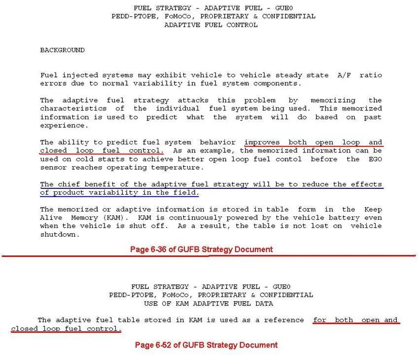

The adaptive strategy correction IS used in open loop, it IS NOT updated in open loop. The corrections done, or learned through the adaptive strategy do apply to open loop mode as well. The system does not use a single, unmodified by adaptive strategy, A/F or Spark advance tables....... open loop tables are modified, tweaked-in, based on the adaptive "offset corrections" (to give it a name) learned and stored in the KAM hence, any alterations made through an AFPR will eventually be canceled in the long run..... - OR - as explained in the GUFB strategy.
