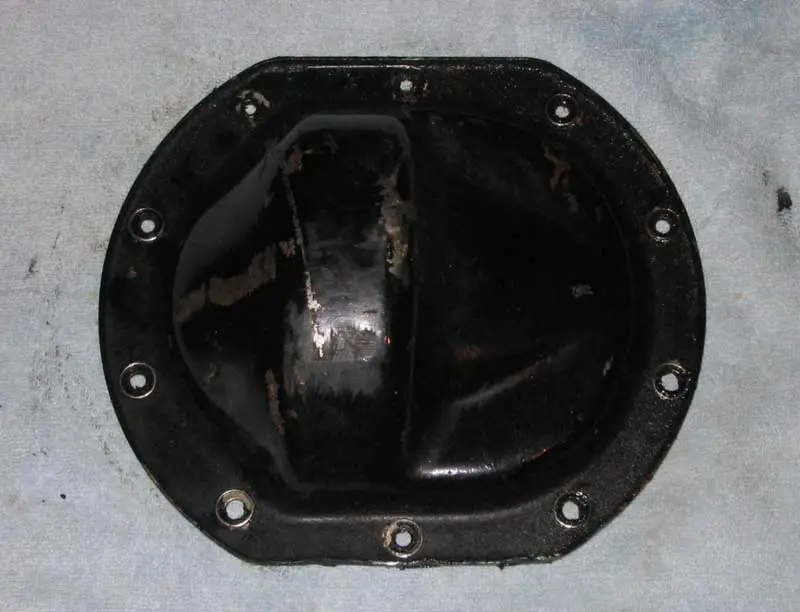

Sorry for all the questions....But I am trying to determine what size rearend is in my car. It is a 86 GT. Guy I bought it from said its a 8.8 but I thought the stangs for the year came with 7.x. Is this true? He said the rear could have been changed but it des not look like it to me. How can I identify it? Take off the cover and measure?
Covers for 7.5 and 8.8.

All 86-93 V8 stangs came with traction-lok and 8.8's.
