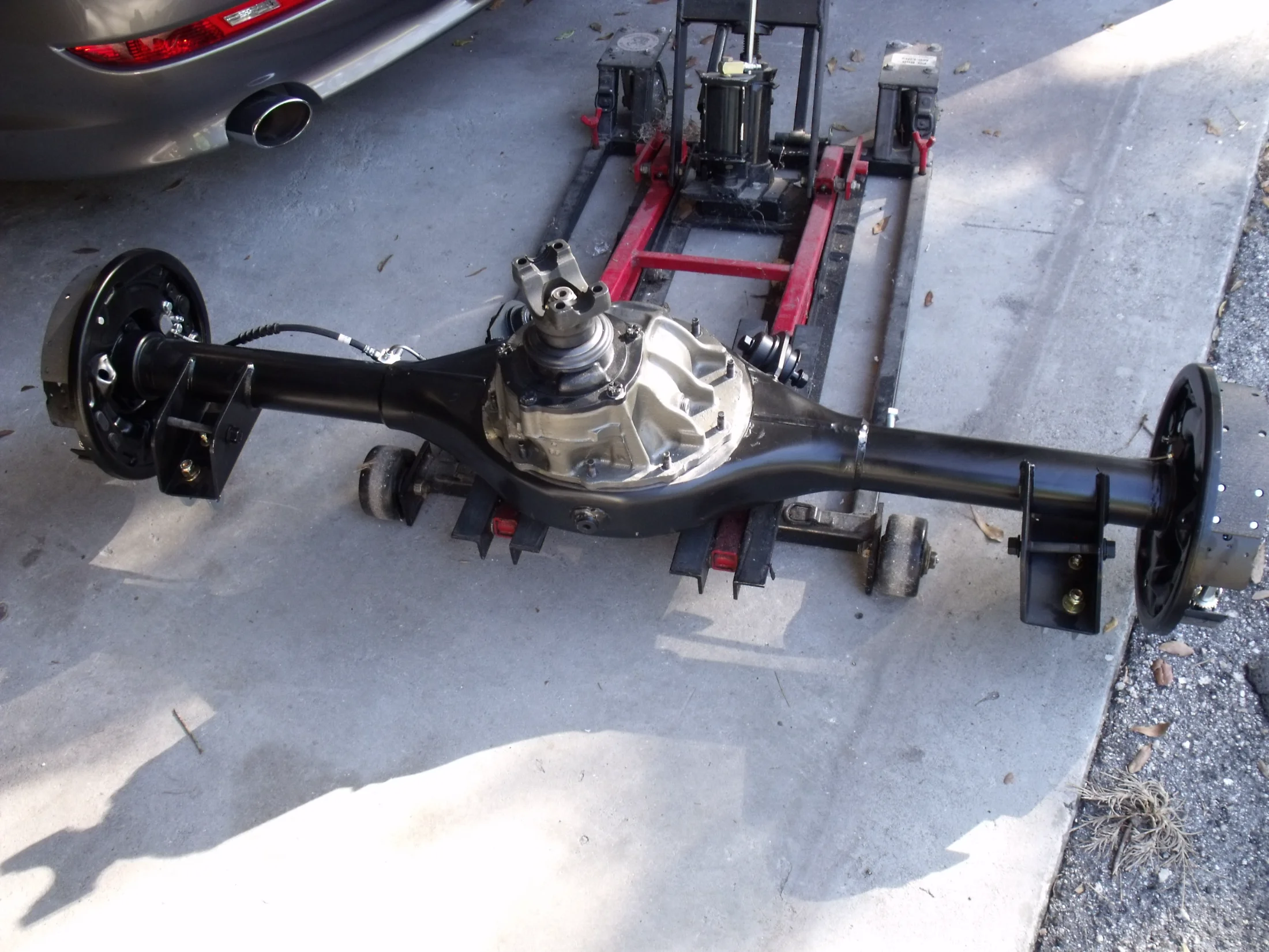

I used this drum kit.. https://www.quickperformance.com/Ford-9-Inch-Drum-brake-kit_p_4031.html
