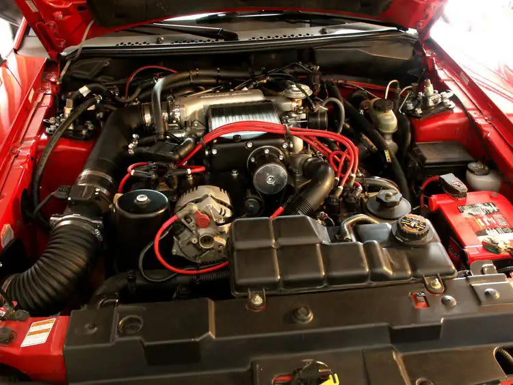

I dont have an autozone around me, i know it's wierd. I had to go to Ford parts counter where it ended up being like $4.18 a SP, when amazon has them for $2.53:( Oh well, i bought them cuz im impatient even though having SPW and SP's comming in the mail at the same time woulda been nice. My car's cooling off now, tho i took one out (Autolite double platnum) and it looks pretty damn good if you ask me. No blue, white and hardly traceable amounts of black. Getting to the passenger side #3,4 is gunna be a bitch:)
and also, I bought the MotorCraft which from my knowlege is pre-gapped to .054, but i dont have a feeler gauge at this house. Should i be fine?
Just looking at the differences between the two, the AGSF has proly 2.5X more threads than the APP 764 Autolite
I just got back from driving, after fixing what was a loose connection/unsealed #3 SPW over spark plug, it runs really smooth under power. Good thing i have new FRPP SPW's comming in the mail, cuz i scraped the wire leading to the cap on hard to reach #4 which was sealed by the hand of god and required channel locks. I just wraped the small tear in the wire w/ 3 layers of eletrical tape. Should be fine for this week
I run the stock OEM Spark plug wires in my 96 TBird. I ran the FRPP wires in my car and I had issues with them. I am not the only one that had problems with the FRPP wires either and I will never run them again. Good luck with them, perhaps FRPP fixed the issue with them, but I will never know.
So the new plugs are in then?
yeah i had a misfire problem w/ them in at 1st, but the boot for the plug wasnt sealed, now they're perfect:nice:
Those are 5.0l plugs aren't they? I didn't know they worked in 2V heads...so i could run the AGSF-22C instead of the NGK TR6?
the AGSF wasnt designed for PI and NPI heads, but it has longer threads and will still fit correctly in our head, helping to secure it stronger than the suggested AWSF
I tried two sets of FRPP 9mm wires. They couldn't hang with the high heat of Las Vegas. Each set lasted no more than one year before the plastic connectors easily snapped off. I ended up with MSD 8.5mm Superconductors and they were fine for two years in Vegas and two more years here in Colorado's freezing winters. I also run NGK TR6 plugs.
