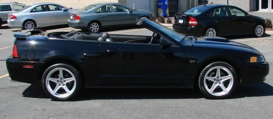

This is my car with the Eibach Pro Kit

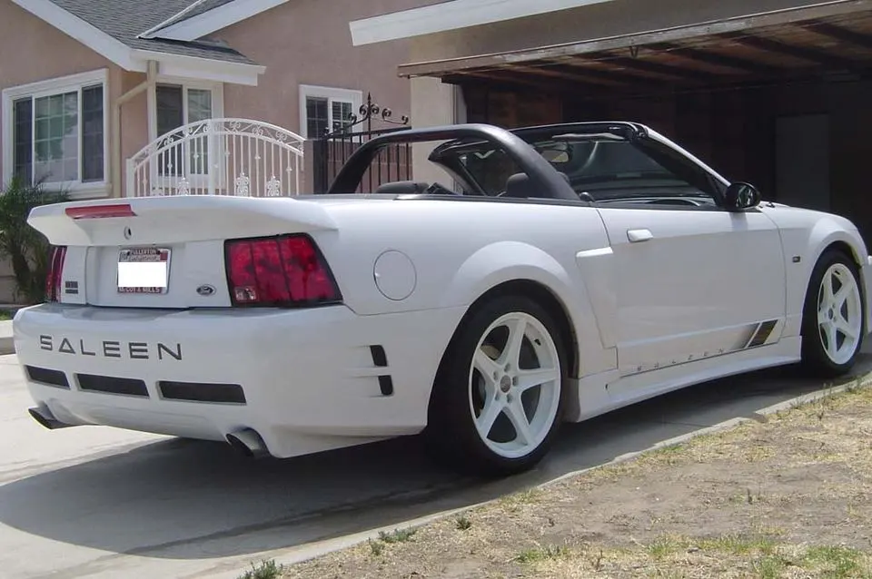

This is my car with H&R Super Sport springs
