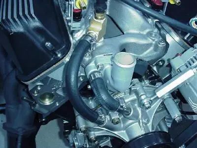

Bullitt95 said:
Thanks Jon. That was the answer that I was looking for and I think the ECT elbow kit from Breeze Automotive Factory Five Racing is what I need.
Well, I removed the heater tube assembly together with the heater hoses after all and used the Breeze Automotive ECT sensor elbow kit to reconnect the short hose from the intake manifold to the water pump as shown in this pic:
I sealed off the two heater core pipes with rubber caps (5/8" and 3/4" size).

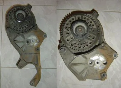

Since I'd removed the smog pump with all the associated hoses, valves, and pipes, I decided to amputate part of the alternator/tensioner pulley/smog pump bracket as shown in the pic below and saved 2lb in the process:
With the EGR gone as well, the passenger side of the engine compartment looks much less cluttered and changing the plugs is now much easier than when all the EGR/smog crap was in place.
