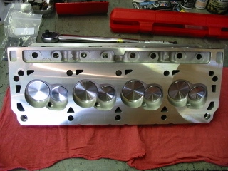

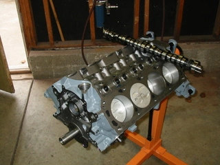

i've got the kit and have had no problems with it. i am however upping the camshaft to a n x303 since i've recently converted the car to a 5-speed. Makes great power from 3000 and up.
