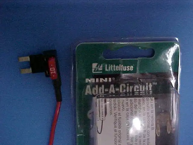

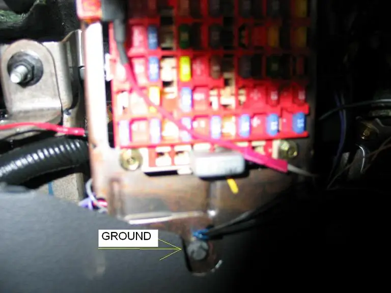

I bought an add-a-circuit (fuse) kit and used fuse location #37 as others mentioned - I just wired in my gauge last night. It was super easy and the gauge is nice and bright when you first pop on the lights. Just plug the add a fuse into that spot and plug in the new fuse as well as the fuse that was in that spot to the top. Also make sure to get the MINI Fuse kit, I accidentally got the regular ones and had to go back.
Some pics I used for reference from an install writeup I found online:
