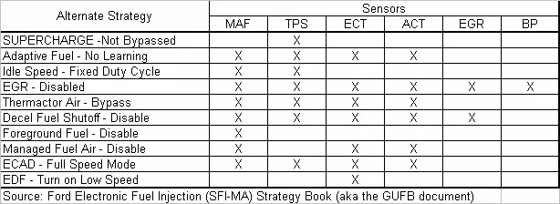

I have been under the impression that when there is an EVP (EGR Position sensor) error, the EGR system is deactivated, the same way it would be deactivated with a custom chip...
Above is the table from the GUFB showing Alternate Failure Strategies.
The Alternat Strategy called 'EGR - Disabled' is used when ANY sensor fails. Basically, if anything except the O2 fails, the EGR system is deactivated.
Again, I need confirmation on this, as my memory is hazy in this matter.
If all of my above comments are correct, then simply unplugging the EVP would disable the EGR. (Not that I recommend this, as there are no performance gains to be made by disabling the EGR system)
