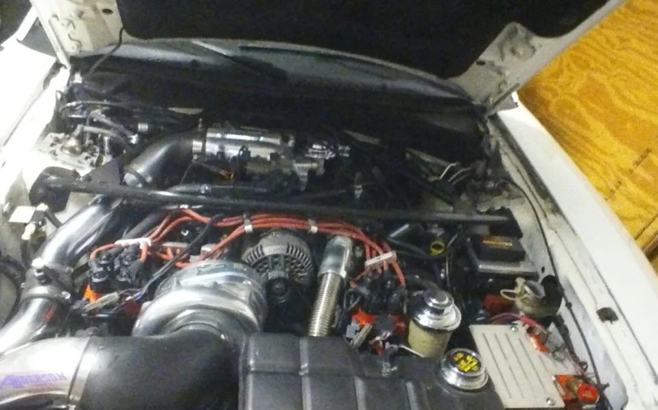

The compression I'm not sure about and the place I got it from said the heads are p&p with upgraded valves,springs and roller rockers. As soon as I get the motor out of the smashed up shell I will get some pics of it and some close ups of the heads with the valve covers off for ya . Here is one of it before the crash.

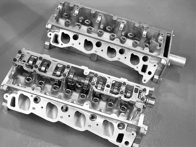

If you take the intake manifold off you can tell by looking at the ports. PI ports look different than NPI ports. In the pic I uploaded, the heads on the bottom are PI heads and the heads on top are NPI. Whichever ports look like the ports on your heads when you remove the intake manifold, those would be the heads you have. If they are PI, and the bottom end is from a 96-98 GT, then your compression ratio should be right around like 10.5:1.
Thanks for that pic .I'll let us know once I have the motor out .I should have that done next weekend .
