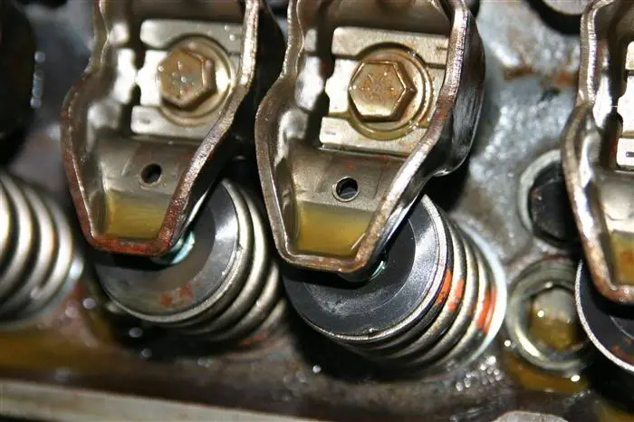

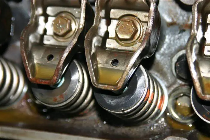

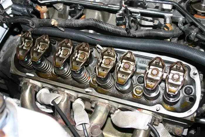

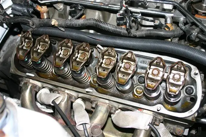

Hey guys I have a weird problem. Oil is just not coming out right..2nd oil change, probably 10 minutes run time on the motor total since rebuild, and it keeps coming out milky. Car doesn't overheat, doesn't smoke, I haven't lost a drop of coolant in the radiator...when I take off the cap it pours out the top. I took a sample of the oil today and put it in a tupperware to see if any water separates from it but it doesn't, it is just really really foggy, I will get a picture of the sample tomorrow, I am going to let it sit overnight. Only thing I can think of it being is maybe the assembly lube grease I used on the cam and lifters but I didn't use that much... When I took the valve cover off today I saw some of the grease on the rocker arm bolt.

After rebuilding the top end I ran a motor flush through it and ran it for maybe 5 minutes and changed the oil. It came out very watery and milky colored but the watery consistency was because of the flush. At this point I wasn't worried about it. I ran the car for about 5-10 more minutes before my next oil change, lots of idle time, few spins around the block, and that's it. Change the oil again and it came out with a thicker consistency but it was very milky. Now I've ran the car for about a total of 2 minutes idle time and the oil looks like what is pictured above.
I took off the upper intake yesterday and re-torqued the lower intake, I found a couple bolts that were at like 10-15 ft lbs but nothing alarming.
The valve cover looked clean, there was one splotch on it that looked milky but there rest of it was very clean.

I'm thinking you have a small coolant leak. I have seen small leaks before that will fool the hell out of many people, the leak could be small enough that you will not notice much loss in the rad or overflow but enough to foul the oil. I'm not thinking head gasket but maybe like Josh stated timing cover or intake. It could be slipping by the coolant ports for one or sneaking in another spot. with the amount of oil changes the assembly lube should have thinned out by now IMHO. that side view pic you posted sure does look like oil tainted with a small amount of coolant, they all do not have to be thick milk shakes.
