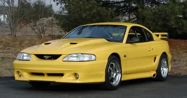

I second just getting the Borla kit if you are going to do it. Coming from manufacturing, if grade of materials is equivalent, mass produced is almost always cheaper than custom. I did however cut off the Borla tips as I didn't care for the dual cylinder look and I had the shop weld on a single wide oval to fit within the side skirt opening. Here's a pic.....

I'm not gonna lie though - the job as a whole SUCKED.
Borla's kit isn't bolt on and go. I had to get one of the side pipes bent to fit up into the exit hole.
The skirts are horrible - I had to get them custom cut, painted, grind down the front - and have to fill in the small space - but the pro is that the kit looks badass - I love the skirts.
I don't now if I'm too keen on my exhaust coming out a bit, but its growing on me - I kind of liked Rio's where the tips just came to the edge of the hole, and not past it. I'm sure he'll post pics and you'll know what I mean.

YES I get to do a little pic whoring lol. here are a few pics of mine. Tripleblack is right, the kit isn't exactly easy to install, but the results outweigh the problems. (pics are a couple months old or so, I've painted the mirrors to match since then)
