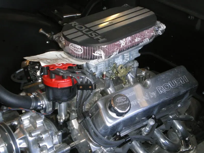

what's this bad boy worth??
1fstpony
Apr 12, 2005
76
Iowa
This is a brand new Roush 342r that a guy needs to get ride of.I know a new one is about $12,000.I'm either looking to put this in my 66 fastback or sell it to make a few bucks. It's actually 3 years old but has never been run. Does anyone have an idea what something like this is worth.Thanks
Those use a sportsman block or a production block? Either way I think it is double what it should cost. You could get way better for that price. With force induction and a dart block you could make 2x the horsepower with $12000.
I see the dipstick is in the location for a double sumped pan, so that'll have to be changed for your '66. Which means the front cover will have to either be drilled or changed for a dipstick.
I think 5k is probably a good price for everything pictured. It may not fit with those headers, though. But they can be sold off for ones that do fit.
Check the prices for similar hp/tq numbers with other crate motor blders to see how the 5k aligns.
Good luck!
