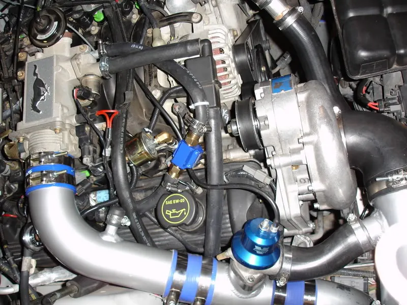

So I tore the car apart today to see if I could find any cause of the lean condition. I checked all of the intercooler pipes, all the hose clamps, the MAF, EtC.
The only thing I found was I blew to tube clean off my PCV valve and there was oil on the valve cover. So I took this opertunity to run down to lowes to grab some things to make an oil seperator. It doesnt look the cleanest, but it does its job.
Its icy here, so now WOT datalogs today. But as soon as the streets are dry I will go at it again. Help/suggestions are still welcomed :)
