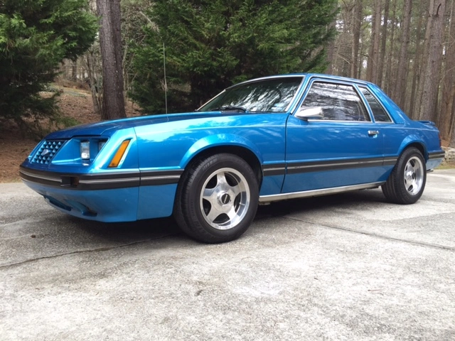

Wifes 84' LX since high school bought new. 51x 8.5 Prime 5spokes..popular back in the day... first new set of wheels I ever bought.
