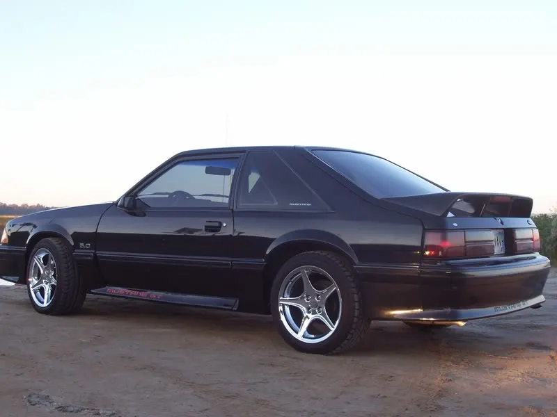

You gotta love the look of cobra brakes with 5-lug wheels though:
Can you pick out 4-lug versus 5-lug when someone is driving?
