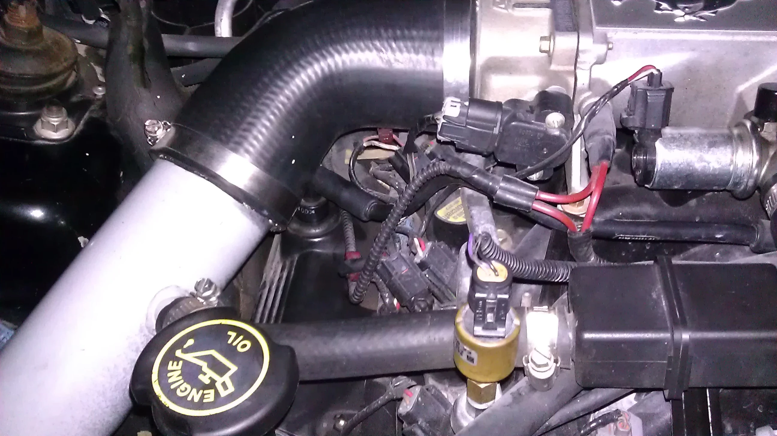

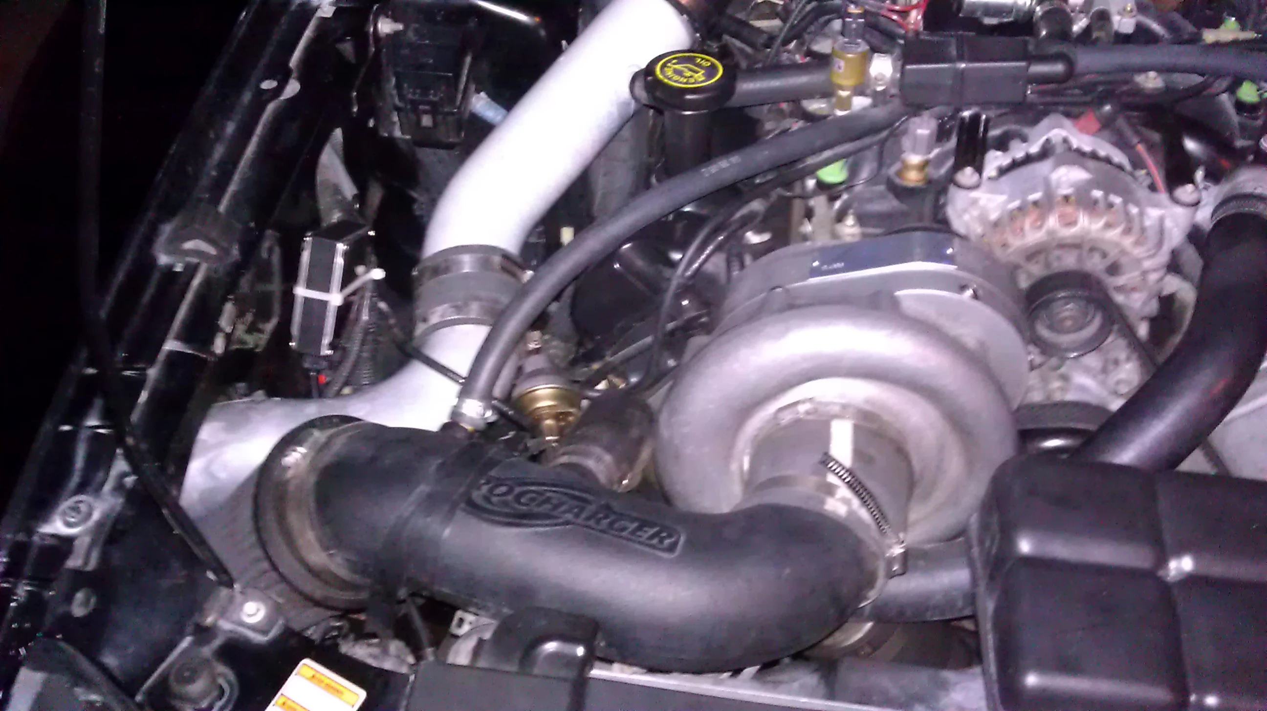

Sorry i was too brief .. About the exhaust smoke its only on a cold start lol and it goes away really fast... i have no cats and i cut my exhaust at the flowmaster
I checked the PCV here

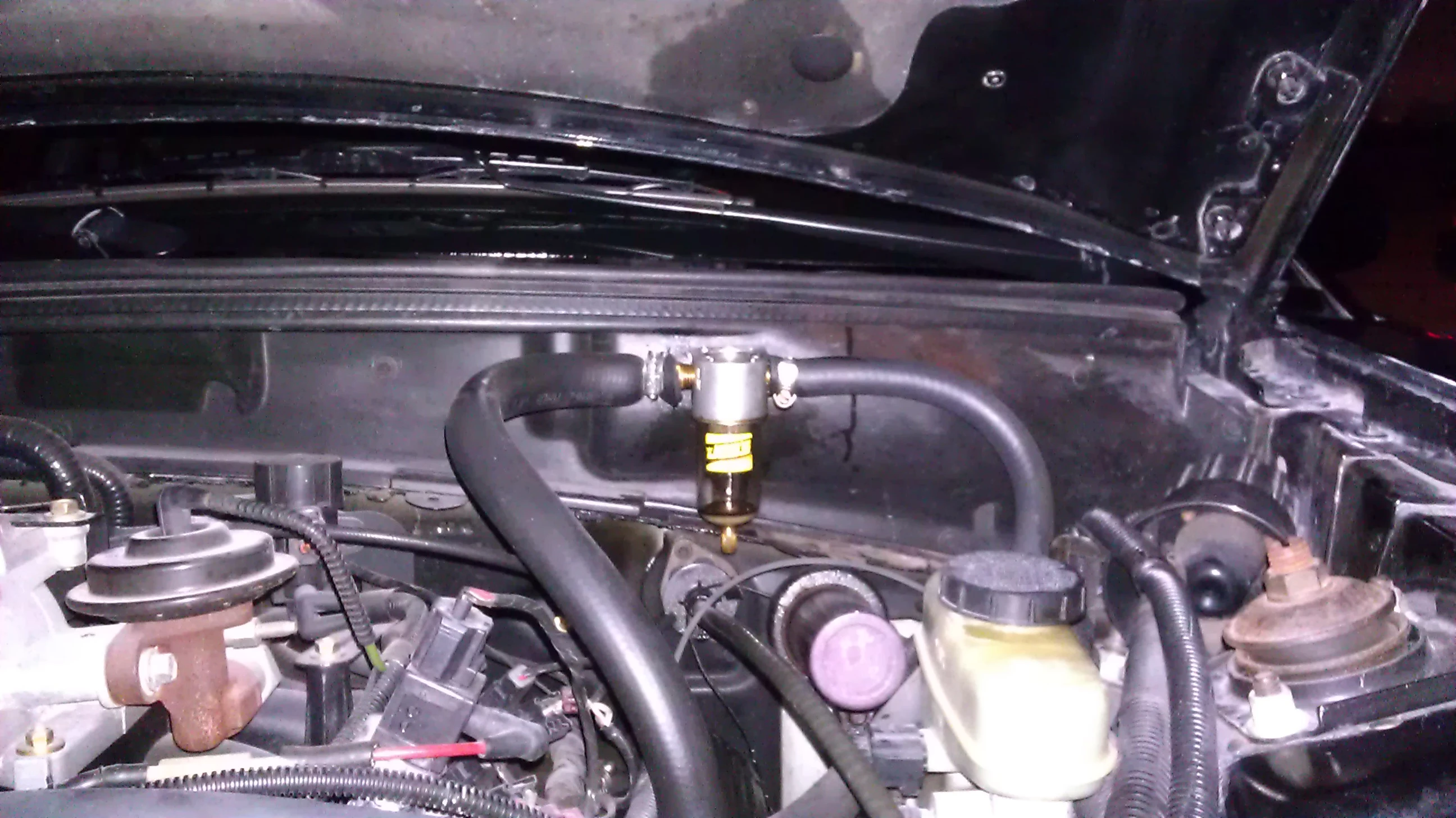

The JEGS oil can is this one
Heres the setup

Ok, yeah, it does look right. Since the smoke out of the oil cap is only there for a second....that is nothing to worry about. Now, the smoke out of the tail pipes....that can be a problem. That is blow by.
