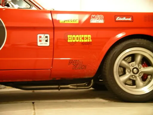

Here is a tip.
Your wheels will look so much nicer if you have quality disc brakes on them. If you can't afford discs, don't get any open spoke wheels that "show off" your drums.
Seriously, it makes the wheels look great.
