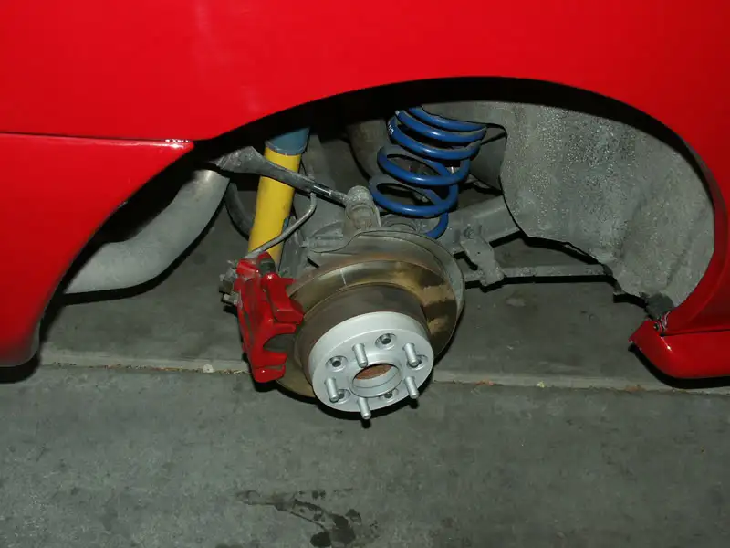

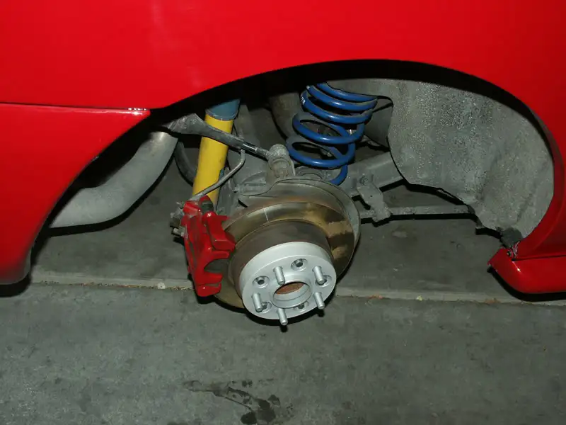

I've had 25mm (1") H&R hubcentric wheel spacers (that I got from MM) on the rear wheels of my car for over 3 years now. I have had no issues with them, and I am glad I got them.
I consider them an appearance mod, not a performance mod. I got them (soon after gettin my car) to move the rear wheels out to where they should be. I couldn't stand the "tucked-in" look, so these spacers were one of the first mods I did.
They fit perfectly on my stock bullitt-type wheels, no grinding and plenty of stud threads for the lugs.
I recommend you spend the extra to get the 1" spacers from MM instead of the cheap ebay ones. However, if you want to improve your ETs, it looks like you need to work on your launch, and rear wheel spacers might not be a good thing for you.
:) :nice: :flag:
Now that I think about it... mine are 25mm. I originaly got the 30mm but started freaking out about my tires rubbing. So rather than roll the fenders I went down to a 25mm. Looks great though. Here's some pictures that I posted at Photo Bucket.
