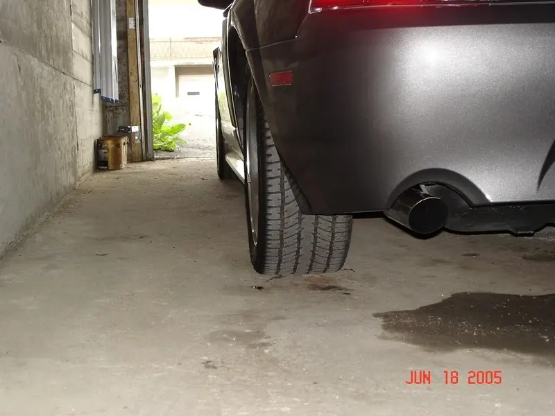

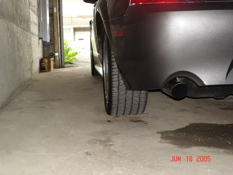

I've beat on eibachs for years w/o problems, all of the folks mentioned seem to make quality pieces.
no tucked in look, no broken spacers.

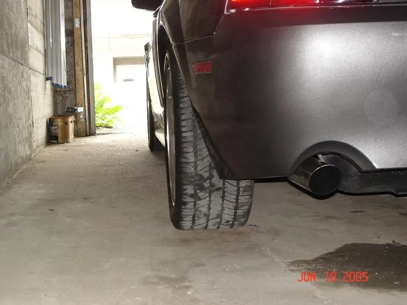

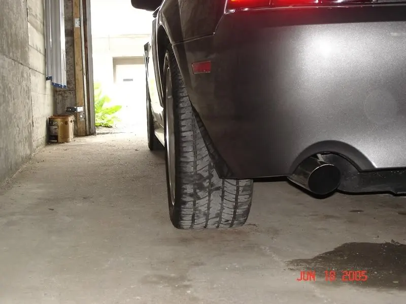

1 inch H&R spacers on the rear of my car for the past 2 years. Drag race once or twice a week every week. Done some lapping. No problems at all to report.
BEFORE
AFTER
