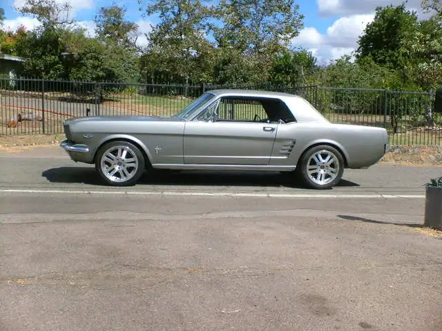

01-04 Bullitts have a 5.72" backspacing so they require a 1" spacer/adapter all around to achieve the recommended 4.75". That's what I currently have on my coupe. I did have to use a 1.25" spacer on the rear but I have a Maverick 8" housing which is narrower. The 05 and later Stang 17" wheels have a 6.3125" backspace which would require an 1.25" to 1.5" spacer depending on how close the inner rim falls to the upper control arm up front. I have a set of 05 GT wheels that I was going to use with new spacers but no one makes an 1.75" spacer I need for the rear. The wheels I have are the ones in the attched pic, not my car though.
