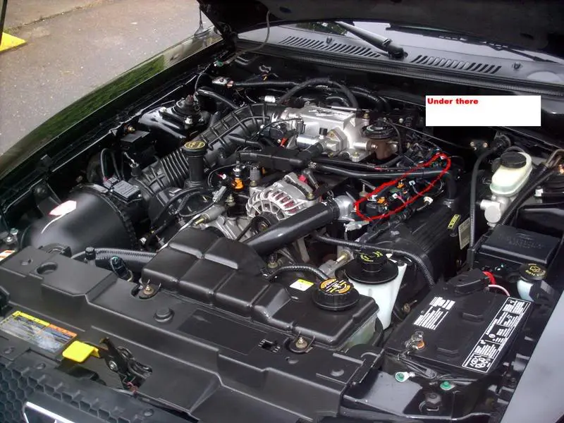

OK on the plugs. In 99 ford put COP on which is coild over plug. If you look at the engine. you will see the fuel rails, then some black plasic things under then. that is the COP. to have to take that off to get to the plug.

The plugs are under the coilpacks. Make sure to blow out the plug holes before pulling the old ones. Then hand screw the new ones in with a socket and extension and torque them exactly to 13 ft lbs. Search for Spark Plug Blowout!
EDIT: Make sure you read up on changing them because the tolerances on these motors are MUCH less than that of the old motors you are used to working on.

Here is a bad picture, kinda gives you the idea.
