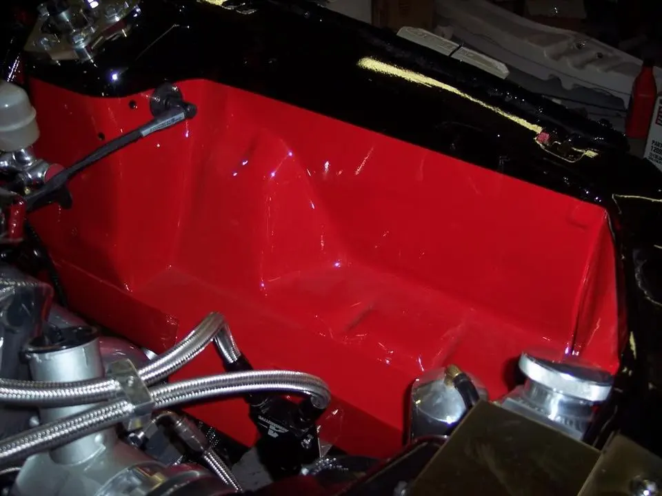

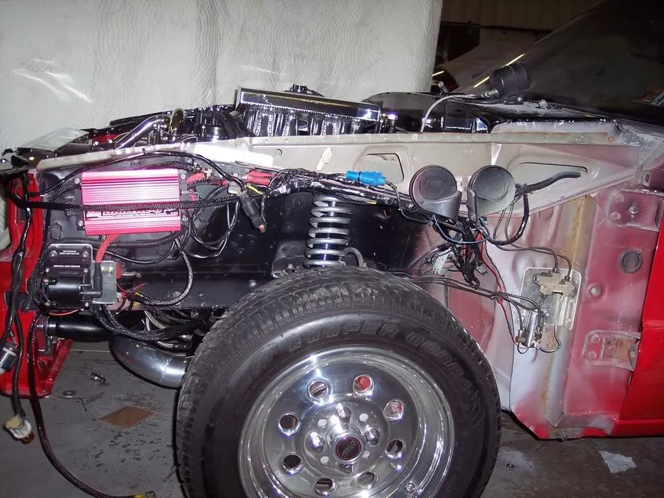

My 6al is in the driver side inner fender, basically on the other side of the battery (stock location). Puts it very close to the coil and battery.
Bent a piece of sheet metal into an "L" bracket, mounted one half to the inner fender metal and the other half is where the 6al is mounted. I'd get you pics, but I'd have to pull out the inner fender liner, sorry.

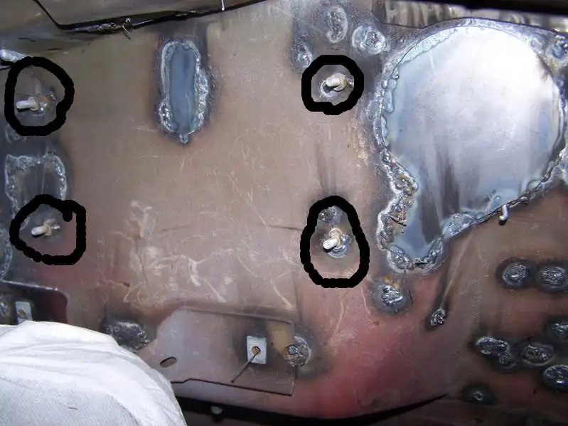

trbofox, that looks clean man! where are all the bolt going through the inner fender at? when i was standing and looking at my engine compartment and thinking where to mount it, i thought about mounting it exactly where you and alanw6 have it mounted. i actually mounted the ballast for my driver side headlight in there (i have HIDs). i'd imagine there's pretty much no way around having to take the fender off, though, huh?

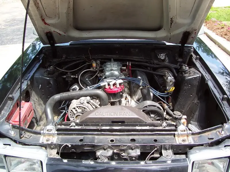

I mounted mine on the passenger side fender, in the engine bay. Running the wires is really simple, I just made a new harness and ran it underneath the stock wiring harness that already runs from the ps to ds, behind the radiator. My car is supercharged, so heat was a consideration, though. I am running the Anderson Power Pipe, so I used the stock Vortech air cleaner shield/box as a heat shield. Also beware of the junk rubber isolation mounting screws/pads. Mine pulled apart on the test drive after installing the ignition box!! I fabbed my own, out of round rubber plugs with the screws going entirely through the rubber isolator (not pressed and glued into the center, like stock.)
Hope my description makes sense. :shrug:
http://store.summitracing.com/partdetail.asp?autofilter=1&part=SME%2D2802&N=700+115&autoview=sku
That's where mine is. I also made my bracket that is similar to the Summit one.
