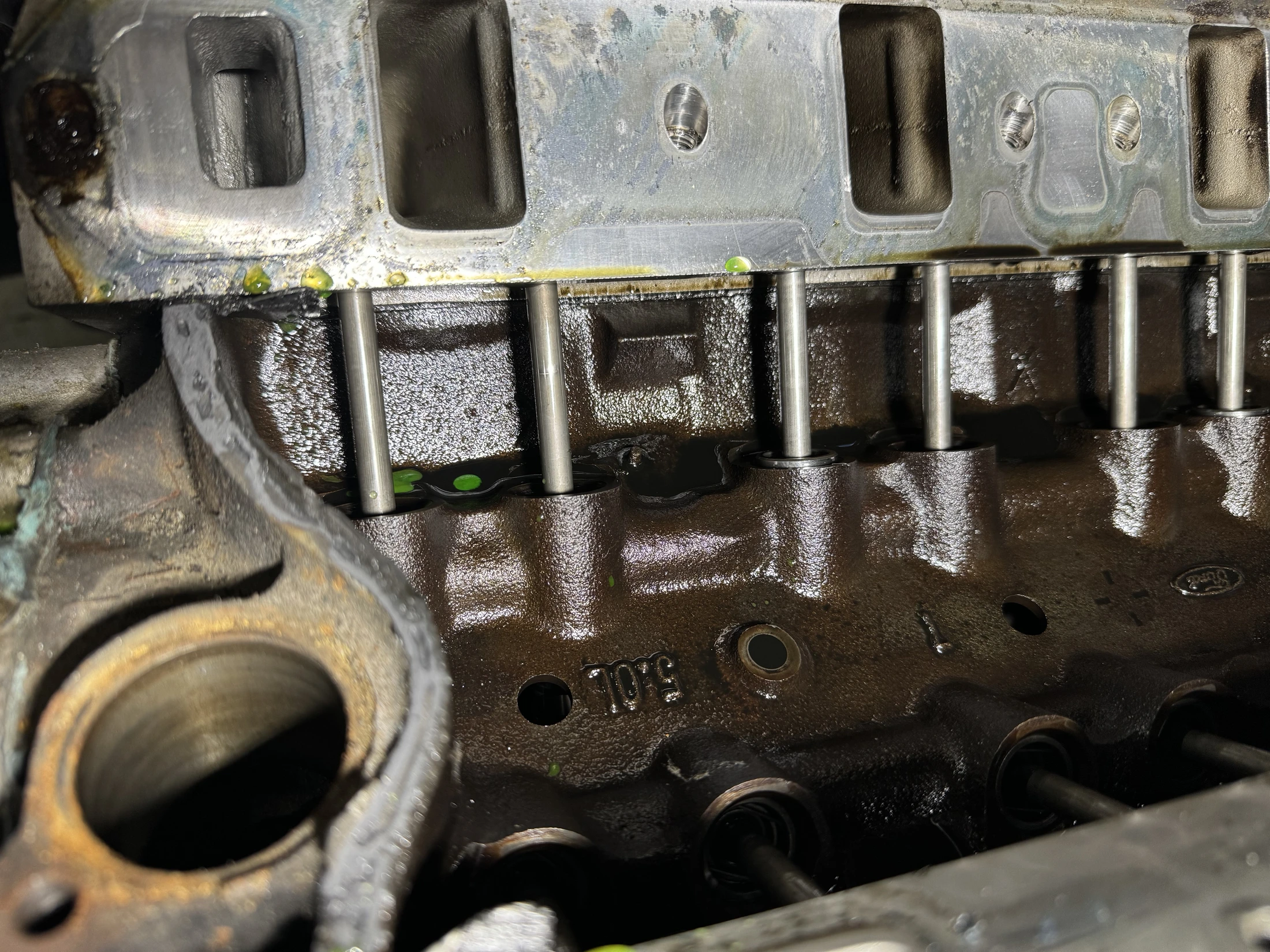

yea i pulled the intake today and set it to top dead to pull the distributor, naturally i was questioning the balancer being spun but turns out 0 is in fact 0. i have no idea why it wanted to run at 30 degress at idle. i did find that the intake does not line up, it sits a quarter inch forward and down so the ports on the heads and intake do not line up and was causing a massive vacuum leak, my theory is maybe is was such a large air charge it wanted high advance like in high rpm scenario but i honestly still dont have an answer.

i mached the intake back up today using some paint to transfer the gaskets imprint onto the head as i figured maybe there was a misalignment when installed. the ports do not match up and are about 1/8th inch lower then the head port and the top of the head port is basically exposed. my best guess is that someone milled the intake for a decked block and or heads. i have the aluminum heads i had planned to use on my other build i could use for testing purposes however i dont have another carb intake to test so i guess im going to just pull the trigger on a new intake and see what happens.

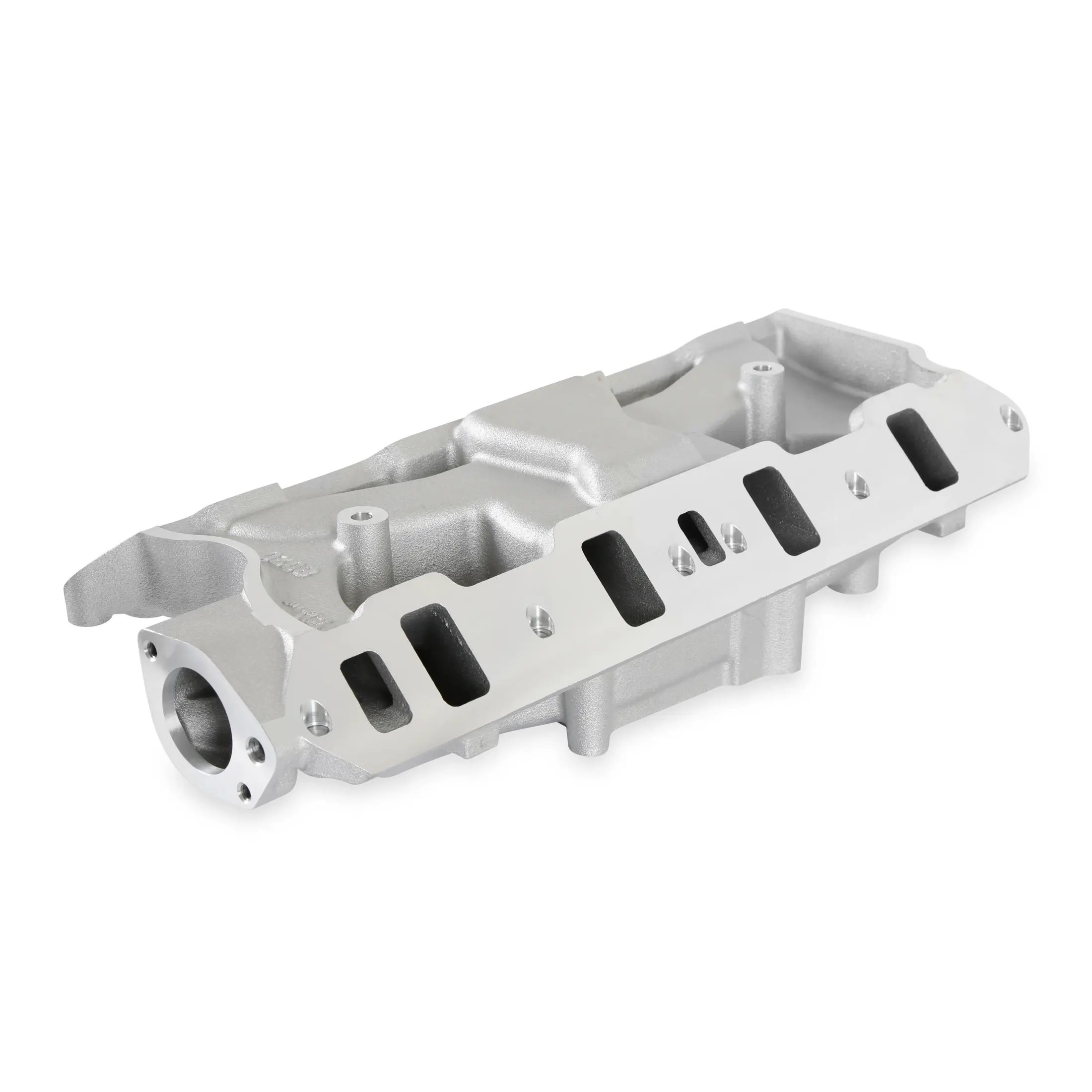

Go here and the front and rear dimensions are under the "Overview" section.
I think you can flip the intake upside down and place it on a flat surface (countertop or the like) like this:
Next would be to use a straight edge on the flat part of the intake that seals to the valley of the block and measure from the straight edge down to the flat surface. You would do this at the back and front of the intake and the measurements should be the same as what is listed on the website.
Hopefully one of the guys with machine working experience can jump in here and correct me as I am probably off.
