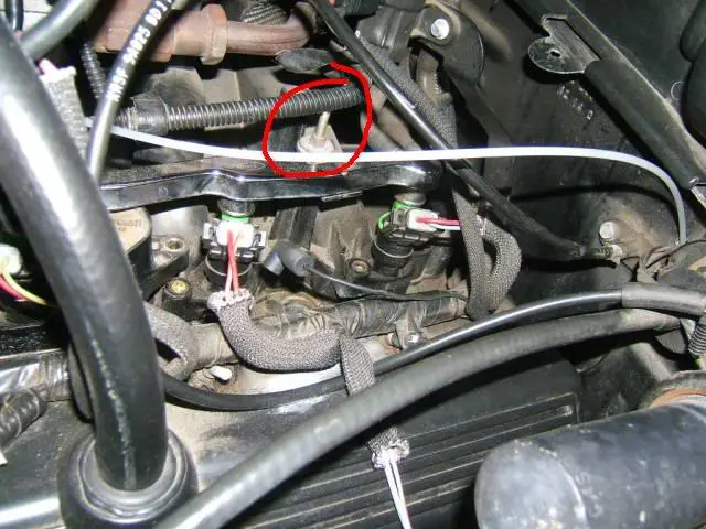

Hey guys, I was checking my spark plugs and cops since my car has been studdering, anyways, I realized this thing was unplugged, but I have no idea where it's supposed to go. Can someone PLEASE run out to their car and check for me, or if you just know, that's cool too. This could be the source to all my problems for all I know, thanks guys!
It's a small black plug, looks like an electrical thing on the Driver's side valve cover near the firewall.

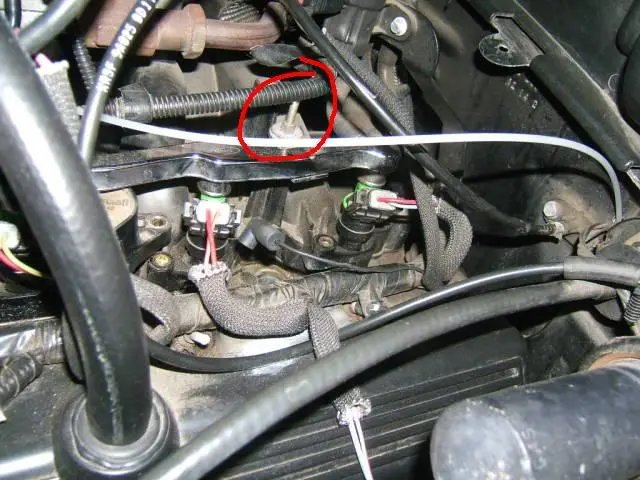

Stand on the drivers side and look at the rear-most spark coil. Directly behind it (toward the center passenger side) is the fuel rail. Directly behind the fuel rail is a threaded stud projecting upward. That's where it is connected on my '03.
