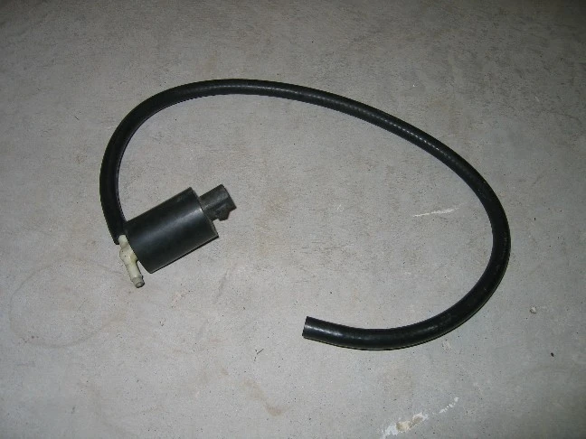

Anyone know where the two hoses that come off the charcol canister go to??
I think one goes into another type of canister that ties into the wiring harness, but from where does it go?
And..where does the other hose go???
I removed the inner fender, but none of the hoses were attached to a vaccum tree...
so the hose that it's in my picture that goes to the intake?
The other hose has a large portion of hard plastic and looked to be routed under the car somewhere??
there is a vacuum tree back behind the wheel well, near where the underside of the antenna is. do you see that? it is not far from the hinge for the passenger's door. if that is gone, then your emissions stuff has been removed and then i guess you don't need this solenoid.
