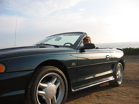

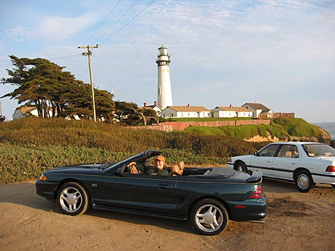

Here are a couple of pics of my 95 Gt
Thanks again for all the great feedback.
Here are a couple of pics of my 95 Gt. I love my girlfriend so much I let her drive it... once.

Good looking car man, I've just passed my first year of mustang ownership. Like Everyone said, get the gears ASAP, kinda expensive, but well worth it. I believe the majority of guys on here recommend the 4:10''s on an automatic. A good set of shocks and lowering springs make for a nice ride as well.
