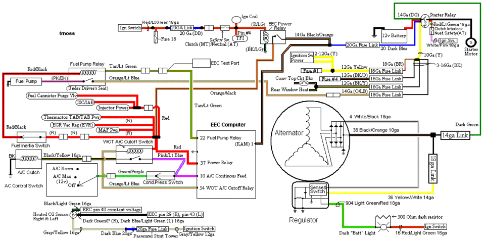

The Fuel pump relay is under the driver seat, as seen on this very useful diagram.
ninety1gt said:
i think mine was on the fender wall on the passanger side
In late 92 was when the FP relay moved to the pass strut tower, but I have seen a few 91 model year guys post that theirs was under the hood........

I read this and knew EXACTLY how you feel. Like has been said it's under the driver seat. Dumb place for it IMO. Should have been in the trunk or under the hood.
