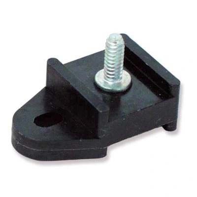

Im currently going to be putting my battery in the trunk of my 69 mach1 and was going to use a terminal block I found from a company but they no longer sell them. What should I do to get some power for running accessories like relays and suck without running multible wires from the trunk? I was also gonna put one under the dash for power for gauges and such.

What kind of terminal block are you looking for? I sell little terminals at work(pretty much a bolt with a plastic casing) for under $10. You run the positive cable from the battery to the terminal and all the wires that were on the positive go to that.
You can have several wires connected to the starter solenoid, but yes it does look bad and can potentially cause problems down the road. I have never had any problems from doing this though.
I would get a distribution block and hook it up to the solenoid and hook everything else up to it.
