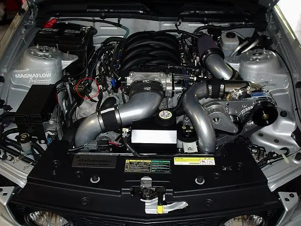

Whereis the PCV?
I don't have a good picture but it's near this red circle. It comes off the passenger side cover and runs into the intake. It's a closed system. Not shown in this pic, I'm now running an oil separator to reduce the blow by oil vapor.

I would not install an open breather system. A breather will pull in un-metered air at idle and may cause you to run lean unless you get a tune with it. As much as it's a pain, I would keep it as a closed system. The only reason I'm having an issue is due to the blower I'm running. The pressure has increase as a result of being under boost.
I went and got a carb fuel filter(2 bucks) and spliced it into the PCV line. Works like a charm. BTW I forgot how the MAF was mounted so I had to take the cone filter back... :shrug: .
