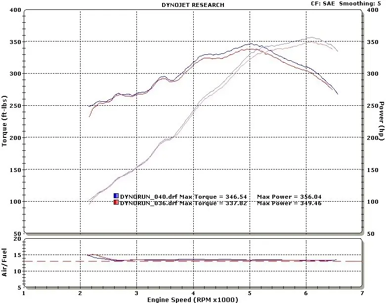

There is a thread covering this in a certain other forum.
Basically, on a heavily modded N/A car (bolt ons plus ported heads I believe) the deletes netted 9 ft-lbs and 7 hp peak to peak, good gains through the band and no loss down low.
On a more stock car you may loose some torque down low, but probably not much. Though, before getting these I would suggest at the least a CAI tune and O/R-H or X, if not headers as well. The added flow will help match the added flow of the plates.
As for which to go with, I'd suggest the economy plates. I kinda doubt that the uber polished ones are worth much more unless your port match your heads to them.
I would like to point out that there is no significant gain in HP until 4000 RPM according to this chart. Additionally, this dyno chart does not even show what the curve is below 2200 RPM and it only shows the curve at full throttle, not part throttle where the plates operate and provide an advantage. I would also like to add that in city traffic I seldom exceed 2500 RPM and often creep around at 1500-1900 RPM to improve fuel economy, which is about 99% of my driving. I just don't see a significant enough advantage in having the plates in my car and I might even suffer a loss in fuel mileage if I were to install them. YMMV

Yeah, the >2,200 data is in conclusive, but you can see the sharp separation of the two right at 2200 when it starts. Though like I said......it's pretty much inconclusive.
The depends on how you define significant, but yeah the meat of the gain is above around 3500rpm or so.
FWIW, the guy who tested it said:
"After driving with these delete plates for about a week, I can say there is no loss of torque or driveability anywhere. Furthermore, with a change in the tune to get the correct amount of timing at part throttle, the fuel mileage is now as good with the custom cams and delete plates as it was stock. All in all, I would have to say I CAN recommend the delete plates for these motors, just make sure to retune the PCM accordingly."
