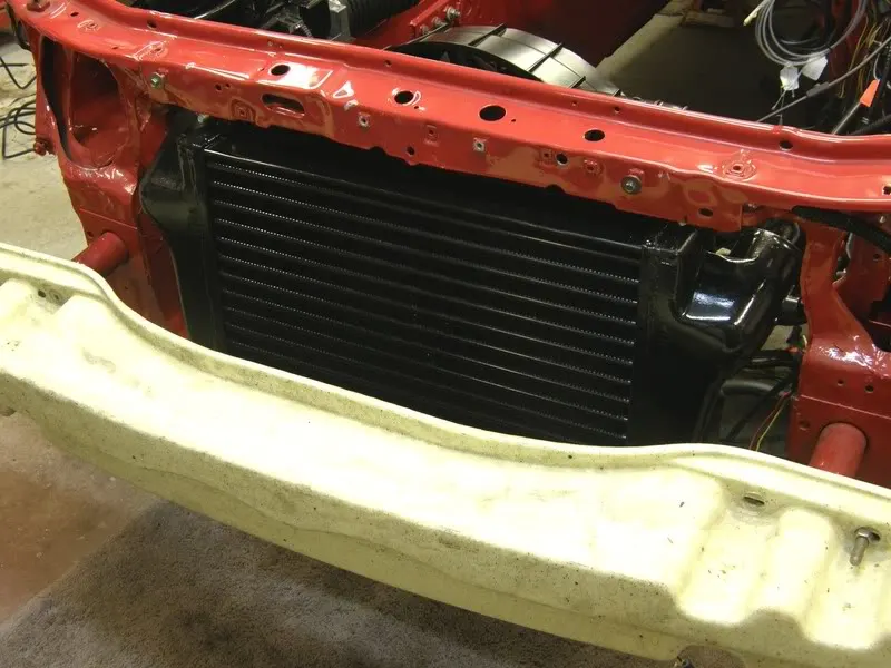

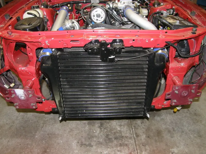

Firstly, I would install a quality aftermarket water temp gauge so you have a more accurate idea of your temps. Also, if you're contemplating a new rad/fan combo, there's plenty of room to move the combo forward (especially since you dumped your A/C condenser). On my '89 I used a Volvo rad mounted in the stock location but I mounted a large Isuzu NPR intercooler in front of the rad. Look how much room there is! A couple of simple mounting brackets is all it took. Granted, I ran a 2.3 Turbo but the rad placement is my point.

I went back and looked at your photos, you seem to have more room between your upper coolant pipe and s/c pulley than i do. Maybe you could put a thicker radiator on. You should take some measurements and compare thickness measurements to some aftermarket radiators to determine what would fit.
