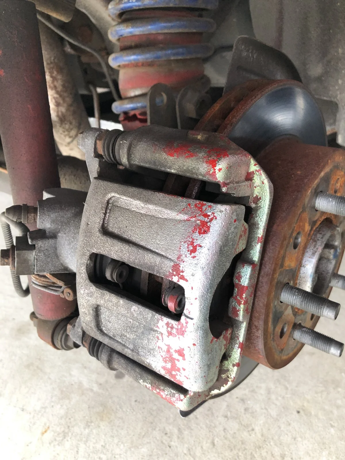

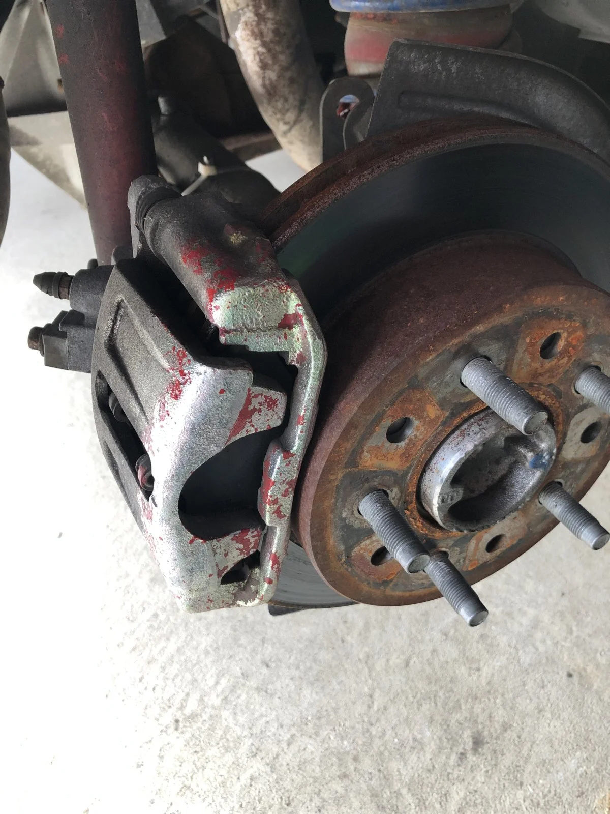

Can someone help me identify which disc brake conversion this is?
Those are 91-92 Lincoln Mark 7 brakes
Was also used on 91-93 Saleens and the 1993 cobra R.
If it is that setup, those should be 45mm pistons on the calipers and 10.5” vented rotors.
What’s it on?
Fairly rare and seldom used setup.
Caliper is same as 93 cobra, so should be common and readily available.
I’d probable pull a rotor and take it to parts store to compare to a 91-92 mark 7 rotor.
Just be aware a lot of parts store computers incorrectly list the 84-90 mark 7 brakes as carrying through 92.
